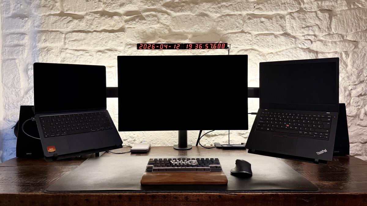

To save you scrolling, this is where it ends up:
Thank you Tim for producing such a beautiful piece of engineering. The Mk III was already my perfect clock; the Mk IV Acrylic has somehow raised the bar.

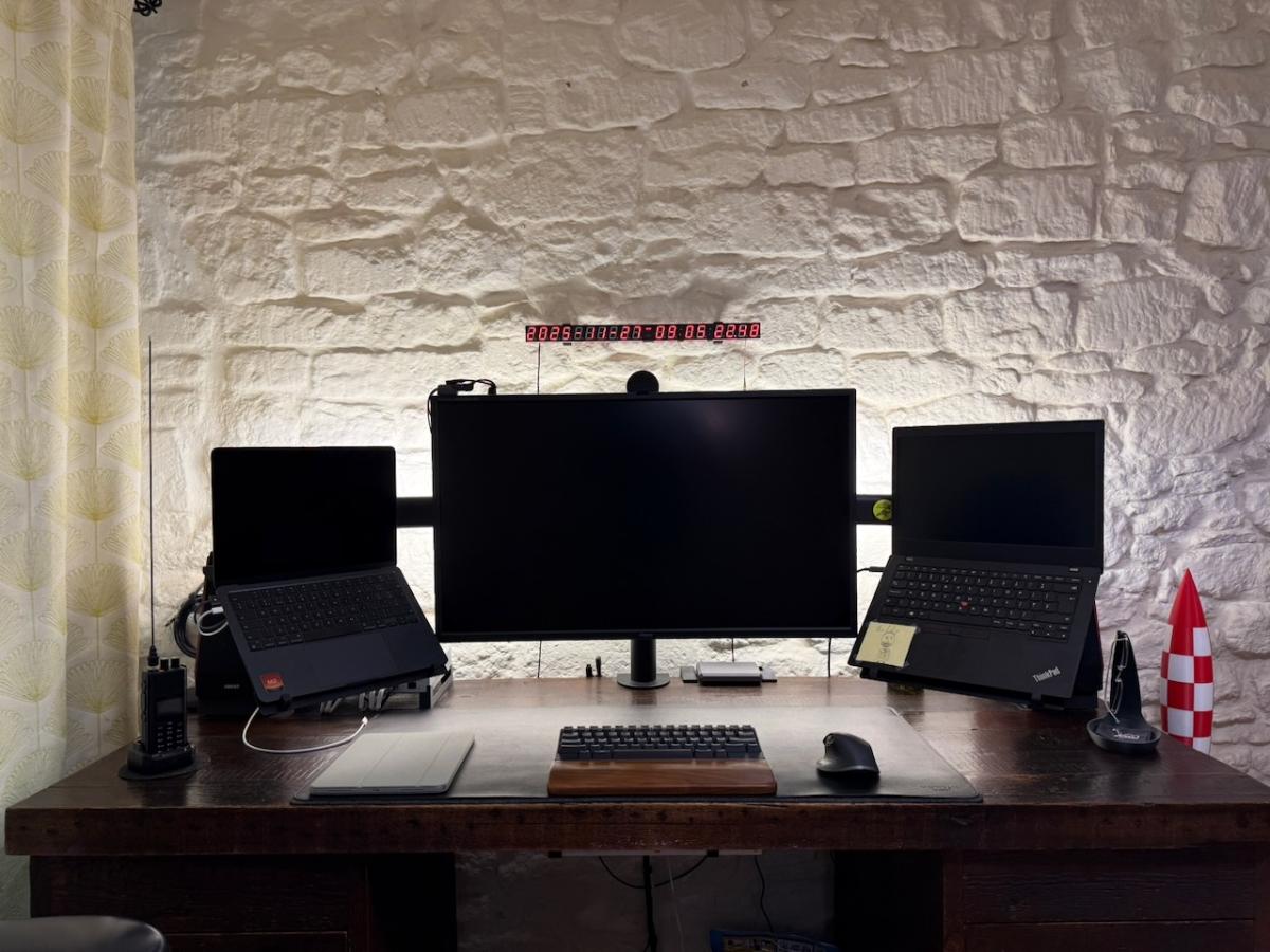

But let's rewind. My Precision Clock Mk III has sat proudly centred above my monitor for a number of years:
I'd never been entirely happy with my screw-and-keyhole approach to mounting; something more flush permanent was overdue, but the surface of my wall is anything but flat.

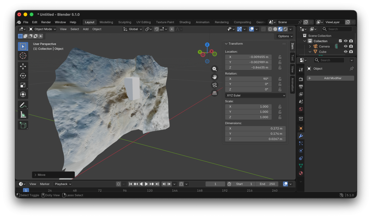

After pondering moulds and Sugru for an hour or two, I took a different approach: I took out a Polycam trial and 3D-scanned the wall surface. (I then forgot to cancel the trial and am very grateful that Apple refunded the £149.99 I mistakenly spent. Expensive scan otherwise.)
I imported the mesh into Blender, sized up a standoff, and subtracted the wall geometry from its rear face; leaving a surface that should, in theory, marry up perfectly with the wall behind my desk.

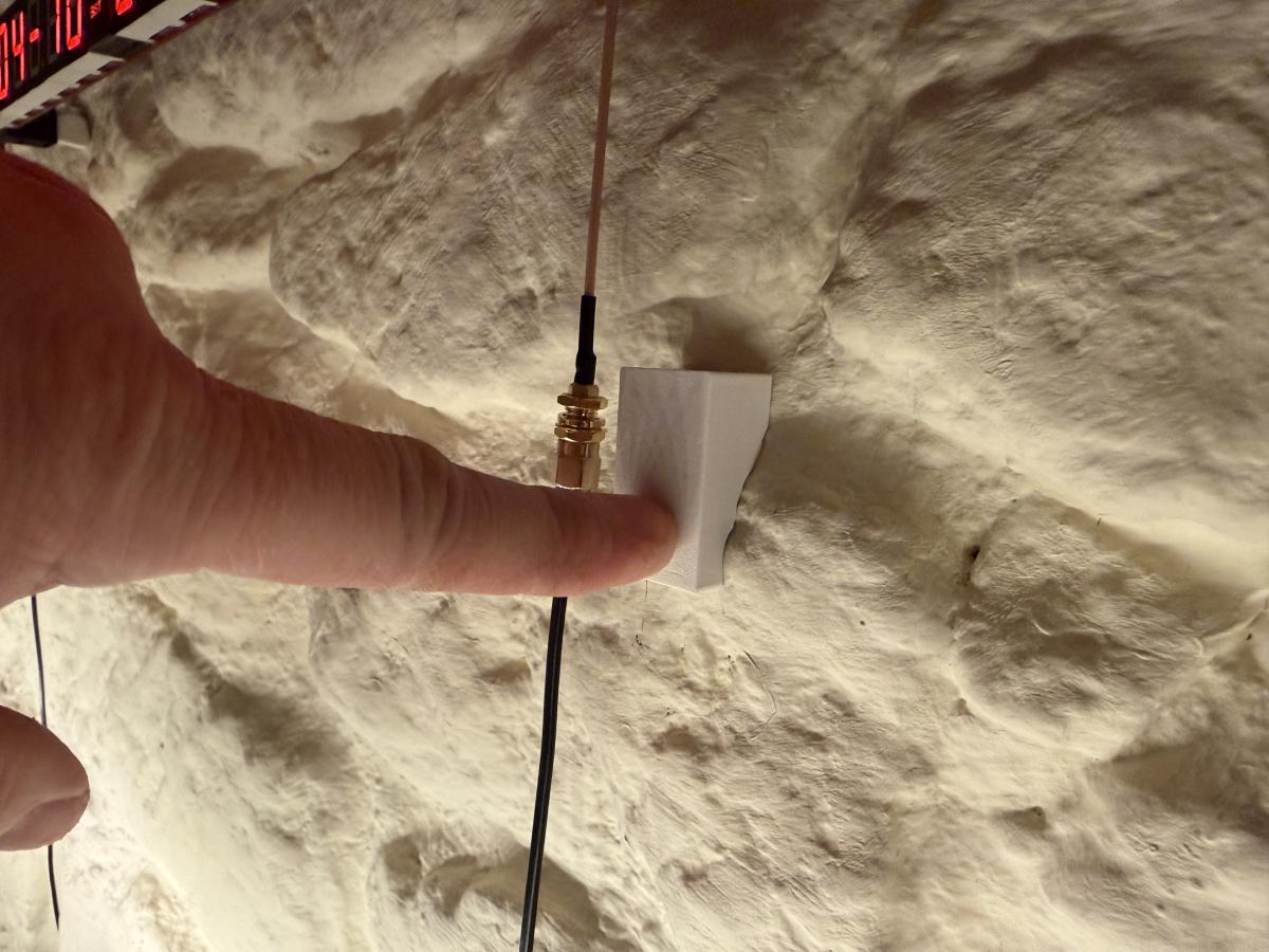

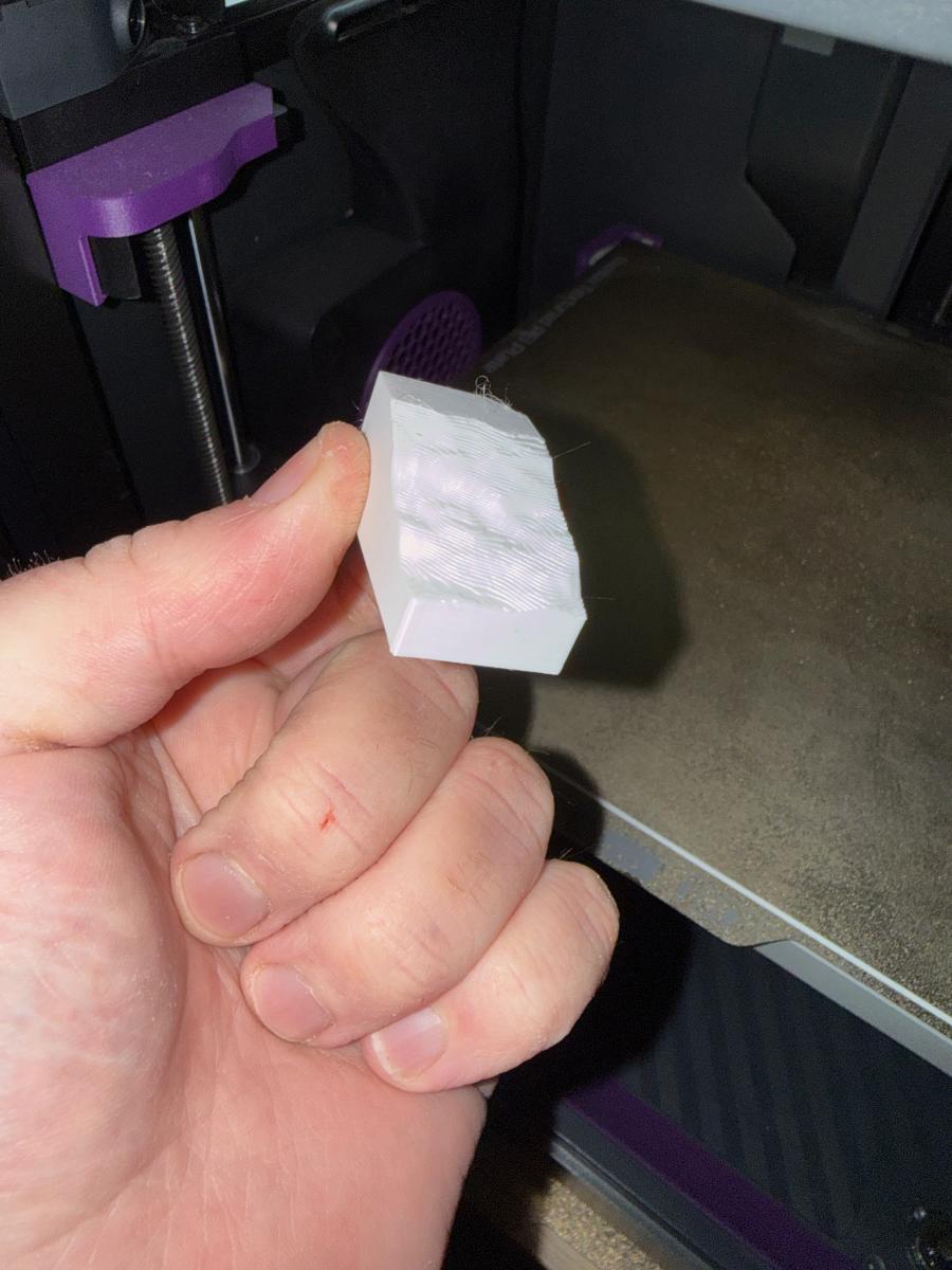

It looked good on screen. The proof would be in the printing. I loaded up the RHS in the slicer and sent it off.
The print (Bambu PETG HF) looked decent, but would it fit?

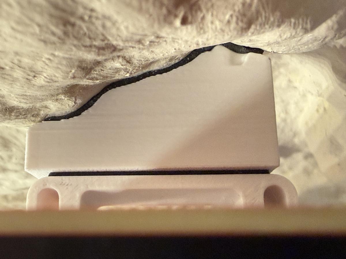

Yes. First print, perfectly flush against the wall. I immediately set about printing the LHS. I briefly considered reprinting with a screw hole, but decided to trust some VHB tape instead...
The VHB is flexible enough to conform well to the contours of the print (and thusly, the wall).

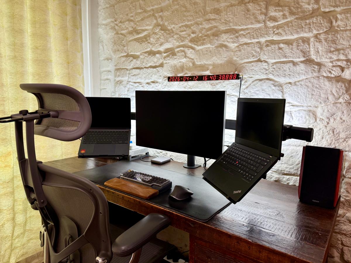

And here's one more of the Precision Clock Mk IV Acrylic Case in its extended wall mount configuration.
